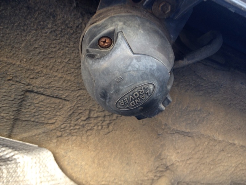

Post #132505 23rd Jul 2012 1:23pm
Posts: 35883
strange you have the electrics but not a towbar... ... - .- -.

I assume that this is the plug for the electrics -

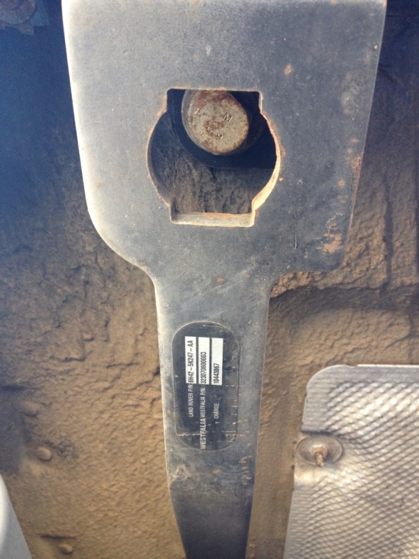

And there's a Westfalia metal frame at the back which the towing eye is part of, but I can't see anything central for a tow bar / two ball. I just have 2 holes on either side like this (top of the photo is the back of the car) -

Post #132509 23rd Jul 2012 1:44pm
Posts: 35883
i think you might have the 'structure' for a towbar but not the towbar itself...havnt seen one of these before sorry...you could pop into a towbar fitting centre and ask.. ... - .- -.
Post #132511 23rd Jul 2012 1:50pm
Mikeyjd
Member Since: 14 Jun 2011
Location: Wrexham
Posts: 543
Wales 2003 Range Rover SE Td6 Zambezi Silver
That is part of the mounting bracket. There should be one each side with a horizontal bar running between them. Normally in the middle of the bar is a square hole for slotting in a tow bar. The hole may be filled in with a square plastic plug with Land Rover written on it. If you have that fitted, just prise the plug out with a screw driver or similar. No longer FF owner but still interested. Present car Jaguar XE

Post #132512 23rd Jul 2012 1:51pm
nbunney
Member Since: 10 Aug 2008
Posts: 2078
United Kingdom 2018 Range Rover Autobiography SDV8 Corris Grey
The two brackets that are removed, when fitting a towbar, are also made by Westfalia
Post #132513 23rd Jul 2012 1:52pm
jfb1977
Member Since: 29 Apr 2012
Location: Bury St Edmunds
Posts: 563
England 2011 Range Rover Vogue SE 4.4 V8 Santorini Black
So it looks like I might have part of the kit, but not all of it.
I'm missing the horizontal bar. Hmmm.... Past (too many to list, but a few favs)...

Post #132514 23rd Jul 2012 1:53pm
Mikeyjd
Location: Wrexham
Posts: 543
The bar doesn't look like it will remove. The whole lot appears to be welded. No longer FF owner but still interested. Present car Jaguar XE
Previous car Td6 SE
Previous LR- Disco 300TDi Auto
Post #132515 23rd Jul 2012 1:54pm
nbunney
Posts: 2078
Nope, the towbar is a 1 piece item.

Post #132517 23rd Jul 2012 1:57pm
jfb1977
Posts: 563
Ok, have sorted it. I need Westfalia part no. eBay Item No. 323074600001 for the tow bar and then I need to buy the tow ball too.
