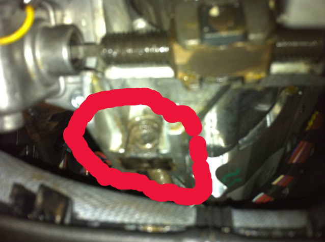

Ive got problems my steering wheel is now not locking in place, it slides in and out freely
The brass nut that the bolt thread up and down and stripped its thread where the tilt motion was mullered, ive fixed the tilt action tonight now but i need to sort out this stripped nut
here is a shot of the part in place
Can u get just this part??
thanks
neil

im getting close to going down B&Q and buying a new nut and putting it in place, i cant find nothing online about that part Sad

Not sure. Can you get a better picture? [img]http://www.fuelly.com/driver/rob2529/range-rover[img/]

exactly my problem...
Hallo cliffy, where did you buy your new plastic nut??? I have the same problem..., greatings from germany, Uli

Its not plastic its fashioned in brass, i took mine out and hit each side with a hammer reducing the hole size and re threaded it and its been fine ever since

Ok, in brass, but at my steering it was a black plastic nut, today I worked one new with M10, and it runs perfectly, next week I will buy a piece of brass, and work like a dentist..., thanks for answer!!!!
