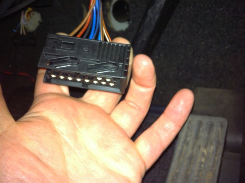

The other thing I found hanging loose is this plug pictured below:
it was sitting on top of the panel that you remove to get to the resister above the drivers feet. Have had a look under there as best I can but can't find anything that it should be connected to. Don't think it's the OBD2 port as I can see a plug on the back of that.

Right, new resistor pack fitted and the HEVAC has returned to normal service.
The Air Suspension fault only occurred after the battery had been drained. The battery was removed from the car and charged for 24 hours before being put back in the car.
After it was put back in the car everything appears fine apart from the air suspension. However, the RSW All Coms can't communicate with the car, nor can a genuine LR TestBook that I've got.
Alternator output is a healthy 14.1v at 2000rpm.
Have had an endoscope up under the dashboard and had a proper look around under there and I can't find anywhere that the plug hanging loose could have come from. There's definitely a multi plug connected to the back of the OBD port though. Does anyone have a 2002 V8 that they've been under there on recently? Was there a random plug hanging loose?

JohnnyDangerous
Member Since: 16 Dec 2012
Posts: 833
England 2002 Range Rover Vogue 4.4 V8 Java Black
Thats a big plug to be hanging loose, cant see a vogue not being fully optioned. One day your life will flash before your eyes......................................make sure yours is worth watching!

Johnny,
That's my thoughts exactly.

cliffy
Member Since: 17 Apr 2010
Location: Surrey
Posts: 556
2004 Range Rover Vogue 4.4 V8 Zambezi Silver
Looks like a lock on connector looks at the side of it

steptoe
Member Since: 23 Jul 2012
Location: london
Posts: 382
That's similar to one of the plugs used in the LCM unit, located behind the drivers R/H side footwell panel.
But i'm sure if that had become detached you'd be have problems with the lights/indicators/stereo etc.

dhallworth
Member Since: 10 Oct 2011
Location: Glasgow
Posts: 3332
United Kingdom 2012 Range Rover Autobiography TDV8 Baltic Blue
Lights and everything seem to work fine apart from no comms on diagnostics and air suspension inactive.

Posts: 6428
Had a trawl through my '02 rave electrical Connector section. The only two connectors that look like the one in your picture are:
and
Now we've got 5 years between cars so LR could have added more stuff..... Thumbs Up .
