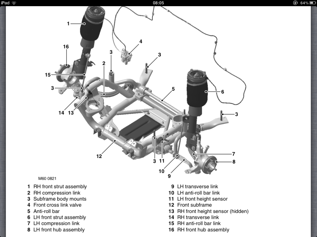

In my experience, and very common with others, it's the lower control arm, transverse link or whatever name others give it. Number 9, or 14 for rhs. Can only really be checked with all weight off the wheel, not ramps. With the fattie jacked up and a hand top and bottom of the wheel, you should feel play.

Good pic - I changed 9 and 14 (which I referred to as lower suspension arms).

Well according to that diagram/picture all I have left to change are 9 and 14. Every time I replace a component the knock/rattle/vibration is cured then 2 weeks later appears in another opponent. They should be with me soon as ordered this week. Anti roll bar bushes next but they aren't on that diagram.
