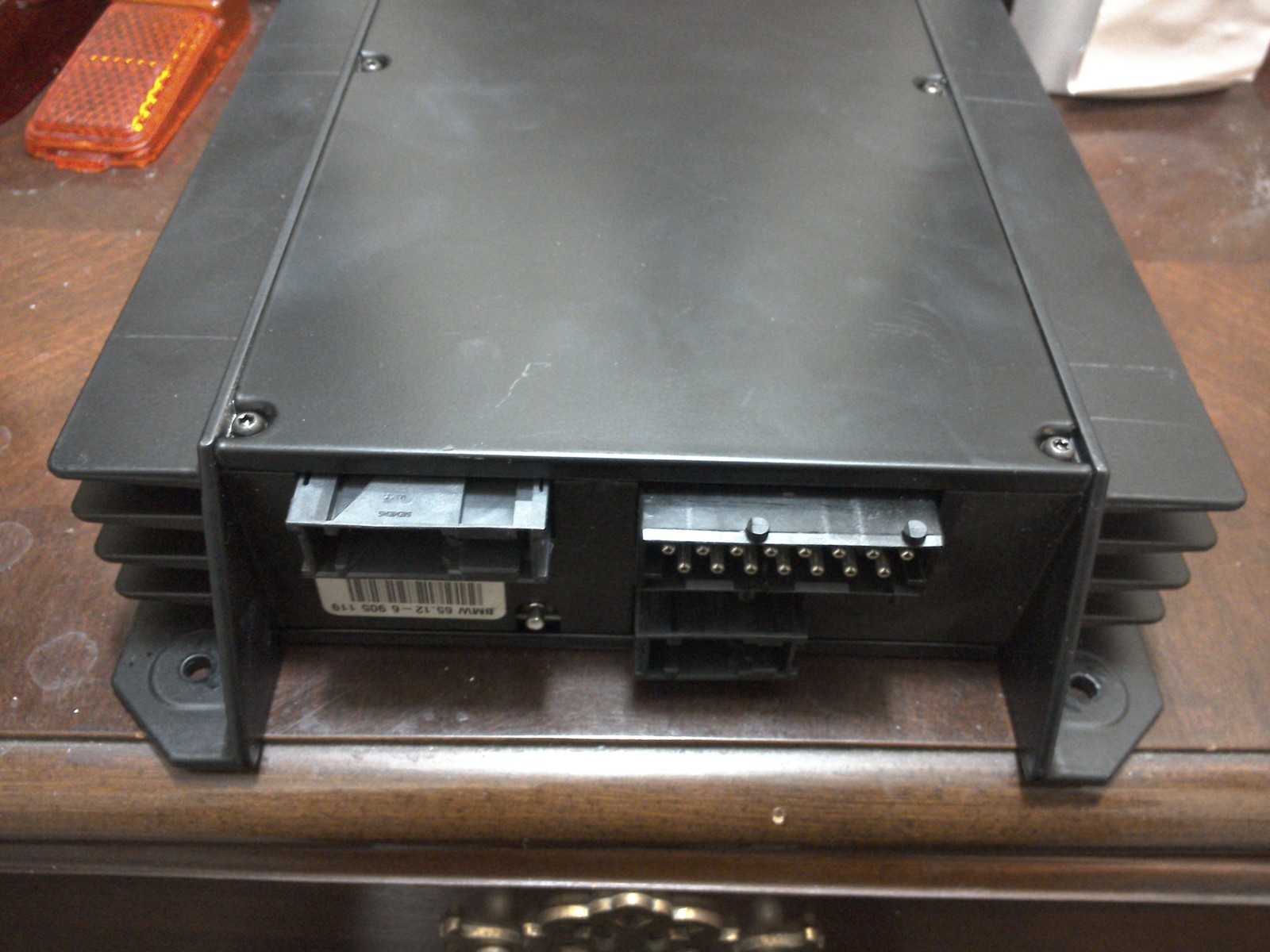

There aren't any fiber optics on yours, it's too old, the DSP is canbus controlled from the head unit, the DSP is a well known problem area, I've just fitted an Android unit to a guy's 2003, he paid £300 to have his DSP fixed and it lasted 1 month past it's warranty...
nicedayforit Member Since: 11 Jun 2011 Location: Beside the Solway Posts: 3984 ![]() ![]() ![]() |
Not sure what the port is you refer to on the DSP but it only has 3 connector plugs, no fibre cable.

the round connector is the one below the plug on the left, maybe not required .
mbmarkyb Member Since: 18 Jan 2015 Location: basingstoke Posts: 22 ![]() ![]() ![]() |
[img]http://i.ebayimg.com/00/s/OTk1WDE0Njg=/z/j20AAOSwj0NUkNsj/$_57.JPG[/img] |
