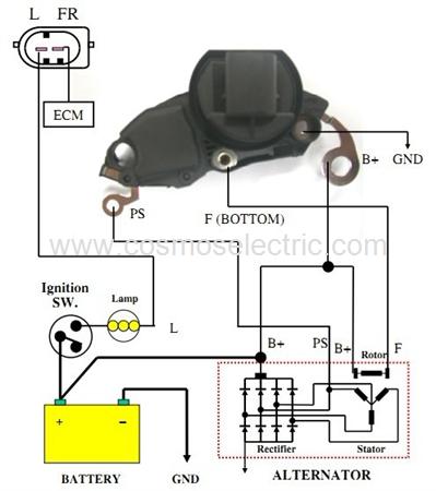

There is one in Hull... I don't think it's the alternator, I think it's whatever controls the alternator... which bit decides how much output it puts out??? It's got a wire going to the ECM does that control it???
The old one did the same, if they put out what they should, 150amps, the battery would be charged in minutes, my battery charger is a 6amp and after an hour the battery is fully charged....!!!
Rave is no help at all.... Pete

So I had a nose around, and from what I can tell your alternator does have a voltage regulator in it, so I can only imagine that the ECM wire is for monitoring purposes (probably linked to the screen of Doom Wink )
The nice chap who performed an autopsy on his alternator http://www.fullfatrr.com/forum/topic34355....er+cooled, did sort of hint that the regulator was a wee bit sensitive.......... Have you been welding your car recently Whistle with the battery connected and the engine off Whistle or playing with high drain electrical items Whistle I would be inclined to suspect the alternator as wounded Sad , and try and blag another before the warranty runs out Wink Yesterday I couldn't spell Engineer... Today I are one!

The Alternators may well have a regulator in them, but they are 'intelligent', i.e. have a control input from one of the ECU's to vary charging voltages etc, Rate of charging of a battery varies massively with its temperature, the colder they are, the more difficult to get charge in (or current out) as the internal resistance goes up considerably at low temperatures - that is why batteries always seem to 'die' with the onset of cold weather.
There is a good description for the 2006 on cars in the workshop manual in the WIKI, although I know these are different to the earlier Bosch ones as they are made by Denso, and are air cooled rather than being water cooled like the Bosch ones (changed mine a couple of months back due to noisy bearings), but I would imagine the principles are the same. 2006 (56 Reg) 4.4 V8 Vogue In Bonatti Grey (Gorgeous!!)

Your quite right, sort of Shocked The alternator extra wire on cars from the 90's defiantly fed the Rev counter.... but they didn't have ECU's or electronic fuel injection. Because our modern cars have fuel injection, the ECU needs to know where the engine is at to squirt the fuel at the right moment. So there are several sensors measuring the rotation of the engine, logic would say that you'd use these to feed the Rev counter, rather than relying on the alternator. But who knows, they still might be doing it the old fashioned way Thumbs Up Yesterday I couldn't spell Engineer... Today I are one!

miggit, whats that picture supposed to show me, I'm being a bit thick???
