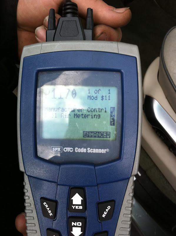

I think that's a generic O2 sensor code, I seem to remembermy old Maserati throwing that code up when the 2 pre-cat sensors were shot 2006 Mercedes CLS

And a quick google of the code...

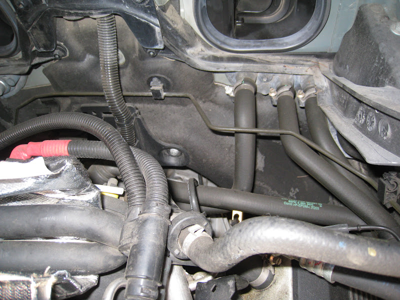

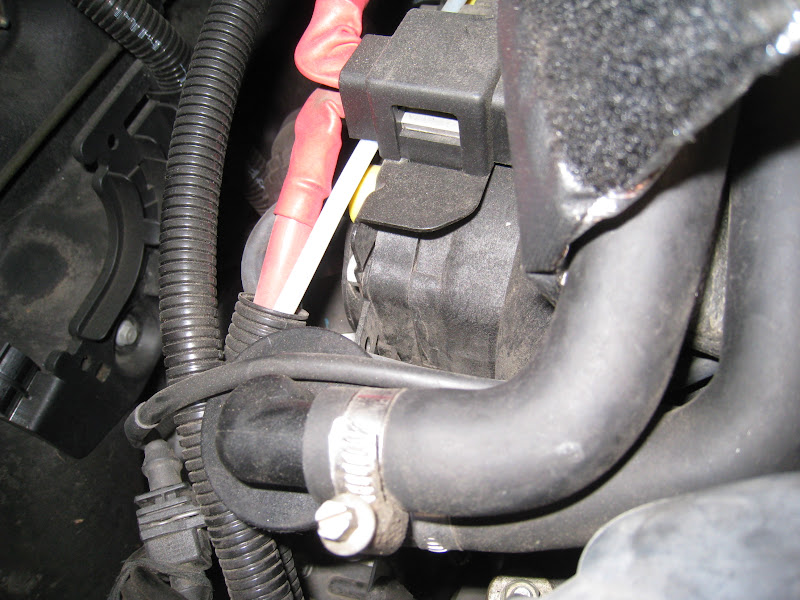

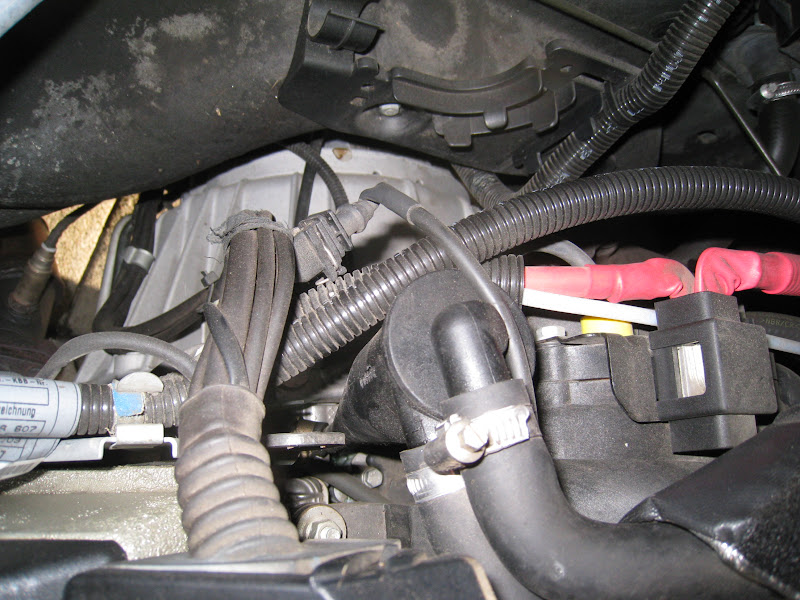

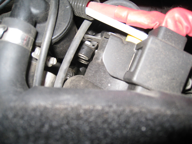

The exhaust is definately worth a punt, isn't there a recall for it in the US? The only reason I'm dubious about it is that the same reason was given to the previous owner of my car by a LR dealer. Yet there is no crack, just leaky PCV hoses. There is also a guy on here who just bought a RR from a dealer with a "blown head gasket" again similar codes. Trouble is vacuum or exhaust leaks cannot actually be detected by the ECU so it tends to throw all sorts of other spurious codes. You posted a few pics on rr.net of your engtine cover off - but I didnt see whether you had checked the hoses? They are further back under the pollen filter housing (easy to remove) RE the code reader, search eBay for USB OBD you want something like this, but preferably more local unless you dont mind the wait. Dan |

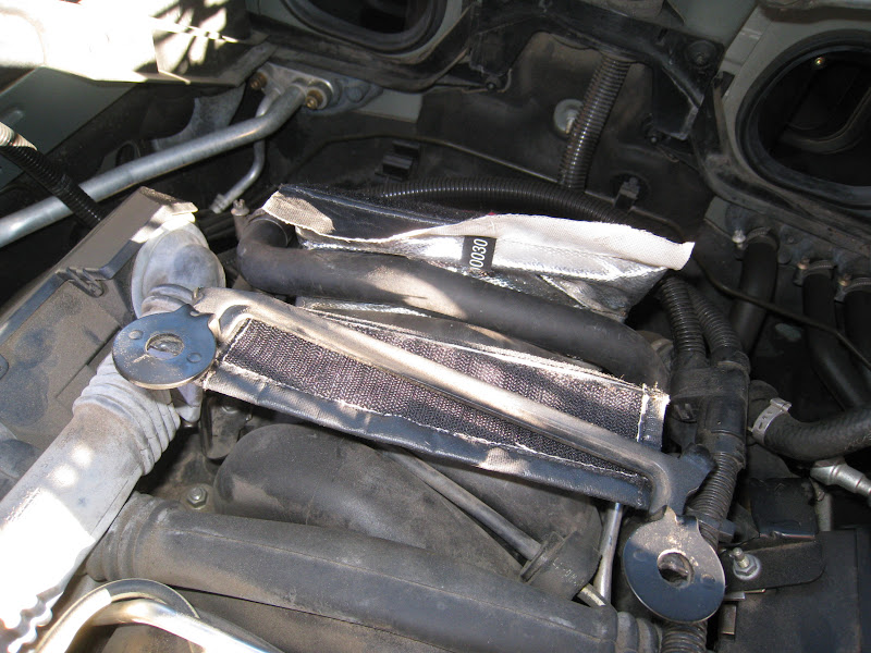

Cleared up and I've become more proficient already at removing the cover. Took off the air fliter this go around as well.

Interesting - your hoses have been replaced at some point. Originally they would have been fastened with BMW crimp clips, where as now yours uses jubilie clips.

Brought car back to my local shop and had them pull the code again. This time
