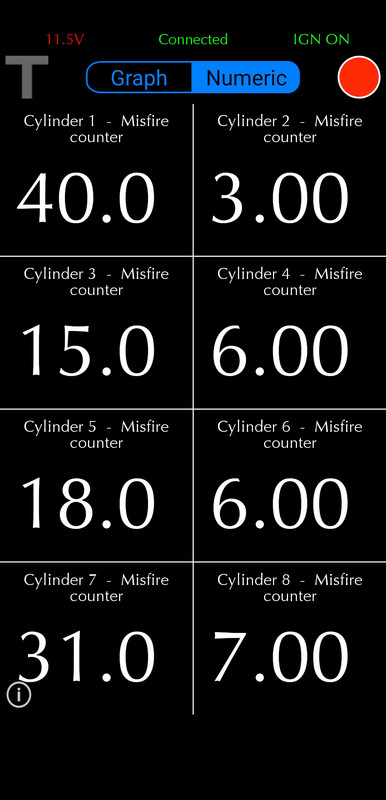

I am seeing very similar...
I have a 2007 SC L322 and just had a rebuild and I get a slight randomised shudder when im in the drivers seat consistently at idle. With these error codes...
I have had new engine rebuild, and new coolant hoses (all), engine and Supercharger water pumps, thermostat, new radiator, new chains-tensioners, MAF, PCV, spark plugs etc. Car runs ok but judders like I said at idle more so, but I believe the judder was there pre re-build and we never saw the following misfire codes.
Any ideas gents. Coil packs/injectors maybe? Any advice deeply appreciated I'm at my witts end after spending alot on the rebuild. Error codes materialised in the first 50 miles after a short stop.

All bank one misfires, camshaft sensor?

Would this be the part your refering to...
RANGE ROVER SPORT/L322 V8 CAMSHAFT POSITION SENSOR - LH
Produit de la marque: Land Rover Genuine
Reference: 4362957LR
Why would this particular part only create warnings on 1 bank? Is this something you've seen before?
Thanks for the thought I need all the help I can get here. Range Rover Vogue SE 2007 L322 4.2 Supercharged 121k. Engine rebuilt @ 120666 Miles

Could be a possibility that the sensor is on its way out or the timing is slightly out on that bank after the rebuild. Try swapping sensors across banks if the problem moves to the other side you will have nailed it (thats if they are not lh and rh parts)
