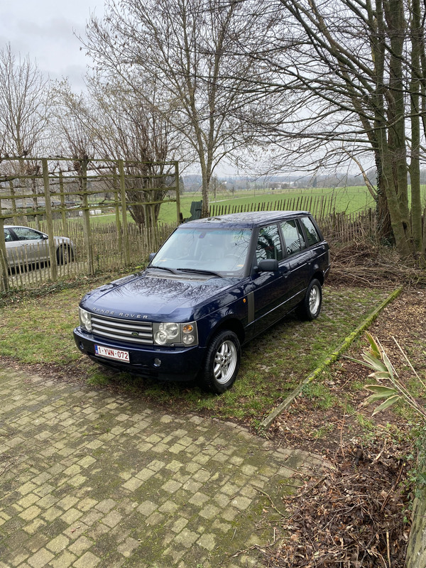

Hi there
Very happy to show you my new daily driver. I was daily driving a 300tdi disco for the last 3 years, everyone thought it was a tractor but I love it, still have it and it will be getting a new engine soon and will be getting restored next winter. Long story short, this l322 is so, so, so much nicer to drive!
I'm a big fan of the look of the early l322's, so classic and it has aged very well for being 19 years old now. Plus you hardly every see early l322's anymore!
I was looking on the Belgian classifieds for quite a while without seeing anything good. Most where too far gone, ready for export and sitting on the bump stops or too expensive (Belgians sure like their TDv8's). The majority of the adds seemed quite dodgy, I'm sure you can get the idea.... So it actually took a very long time to find a nice TD6 l322 as they seem to have vanished from the roads here. Funny thing is that you still see a ton of the uglier original RR sports driving around!
This this one popped up at a classic car dealer with a newly rebuilt auto box, I saved it from the dealer as he was planning on tinting the windows and putting RR sport wheels on it!
2002 TD6
Rebuilt transmission
276 k
Interior is pretty clean
Extra set of oem wheels
So whats wrong with it?
Passenger side carpet is soaking wet ( Dont think its the AC line)
doesn't warm up all the way (have a new pump and thermostat, might delete the EGR)
vibration when braking at higher speeds
Rust bubble on rear quarter, will get it repaired in the summer
difficult first start of the day, turn the key and hear a whirring sound and no start (bad battery? I also get the HDC inactive message when starting)
the lever for low range is broken of
Wheels need refinishing
It will be getting a 2 stage polish once I find some spare time[/list]

I do like the colour mate . Very nice. Thing is, the steering wheel is on the wrong side. Mr. Green

Looks a nice one. Thumbs Up
