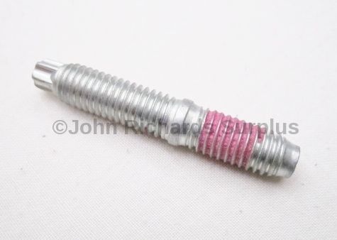

I am getting a lean code on the bank with only one nut holding to the manifold I’m guessing this is expected if it’s slightly blowing?
It looks like this
Do I just need an inverted torx sockets for removal or something more special? Current stable:

Yes, you will need the torx socket to fit the new bolt.
To start with, as above you may need to put some heat into the original first, this will also destroy or soften the thread lock compound if on the thread.
You could try locking two or three nuts on the thread, IF the there is any good thread left.
You could also try one of the below - lots of different tools around, the fourth one down is excellent for removing good studs with minimal damage.

What he said...... Thumbs Up
Leaking exhaust up stream from O2 sensor can give a lean code as it can draw in air from the blow then the O2 sensor thinks it's running lean.. Thumbs Up Pete
