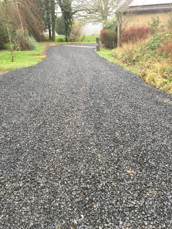

We have a significant area of 20mm Basalt chippings which I've put in the plastic honeycombe structure you may have come across. They hold the gravel in place (despite slopes) and it doesn't tram line as long a you only go a few mm deep on top of the plastic grid. Only maint I've needed to do in a couple of years or so is add a little more gravel where it had settled and you could start to see the grid edges - looks better when they're properly buried, but go too deep and you get tram lines.
But of course we all need a hard standing to operate a machine wash bay - doesn't every house have one??? Rolling Eyes

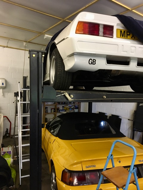

Is that a cheaky M100 poking it's bum out there ? Very nice toy.
A. Fuji White / Jet 2012 4.4 TDV8 Westminster
Post #699286 1st Sep 2024 11:08pm
Posts: 641
Oh yes! Been a Lotus fan boy for more years than I care to remember. Doesn't usually live there - normally tucked up in the barn...
Apols for going so far off topic Embarassed Mike - MPx
