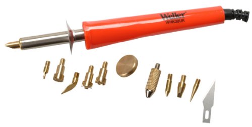

Nice job, they look great, used the same method on my old reversing lights.... My gas, soldering and wood burning kit, came with a very thin blade which cuts with much less width than your cuts, they are excellent for dismantling lights as easier to make good Thumbs Up
Example pic
Example pic
Thanks Haylands! Thumbs Up
That's what I need to invest in! Thanks for the heads up. I was looking at making something similar but managed to get the wider tip to work the way I needed it to Wink Kiwi lad - Range Rover TD6 L322
