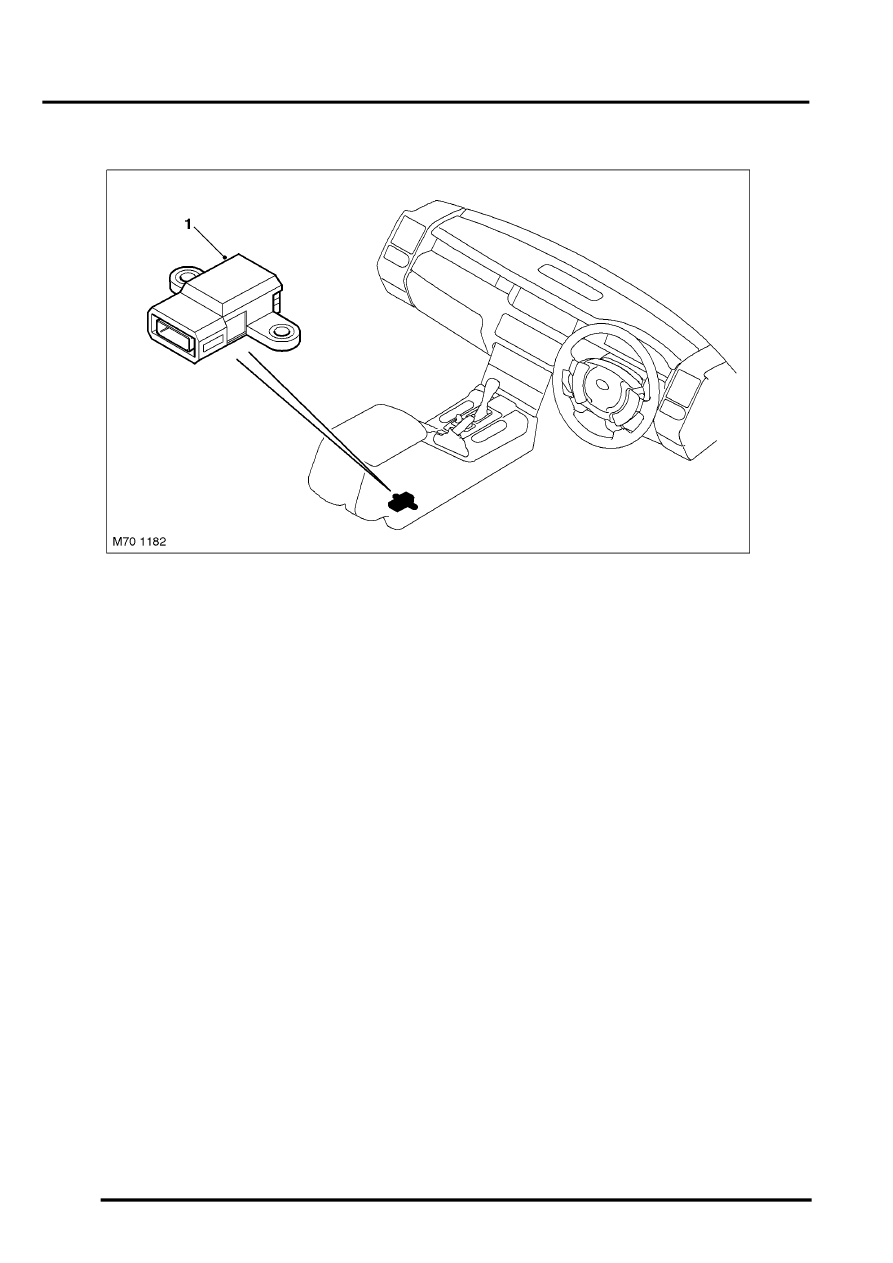

Looks like faulty Yaw sensor, it's here..
And yes also looks like a height sensor failure..
Think I'd be tempted to do the height sensor first and see if it clears the Yaw fault... You never know...!! Pete

I think thats the route i will be taking after xmas, Replace height sensor pop local garage to calibrate.
if not fixed replace the yaw ECU !.. looks like nightmare to get too though, 2003 Range Rover 4.4 Litre V8 - Adriatic blue
