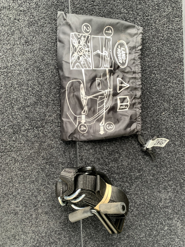

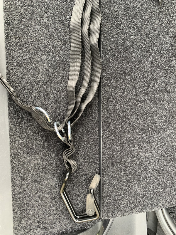

Ok, so here’s some pics.
First this is all you get in the kit
The flat metal plate goes through the wheel centre acting as a hook.
The big hook end hooks on the top of the hatch opening.
You need to have removed the parcel shelf and boot floor for it to work, but essentially just pull on the webbing loop and it lifts the wheel out.
You may be able to see the size/scale from this
HTH Mike - MPx
