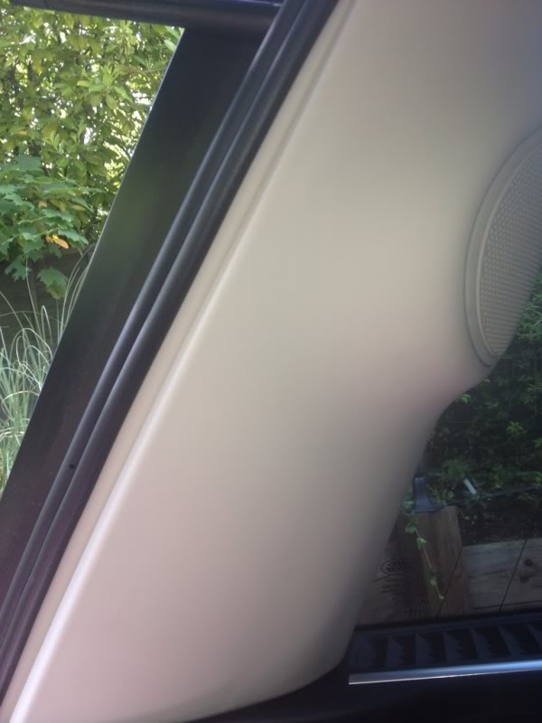

I've had marks all over the inside of my pillars (they're cream plastic in my car) since I bought the car.
I'd tried everything to clean them - hot water with washing up liquid, Swarfega, meths - all sorts - but the marks were more like scuffs and wouldn't budge.
Anyway...I was tinkering about today and remembered I had some 3M rubbing compound kicking about (it's called "Perfect It" and is a very fine abrasive for finishing paintwork etc).
Thought I'd give it a try on my immovable marks. It worked! Thumbs Up
BEFORE.
AFTER.

Well that looks excellent.
Have plenty of scuffy bits round my tailgate on the trim, and mine's ivory...........
May try a very small amount of car polish then.
Its not textured plastic, so shouldn't get ingrained........

Just to be clear, I used an abrasive rubbing compound rather than a polish. My interior plastic actually IS slightly textured - at least it's not "shiny flat" if you know what I mean? I just used a kitchen wipe to remove any residue afterwards.
I'm guessing that actually something like Cif (or another abrasive cleaner) may have worked equally as well. Past (too many to list, but a few favs)...

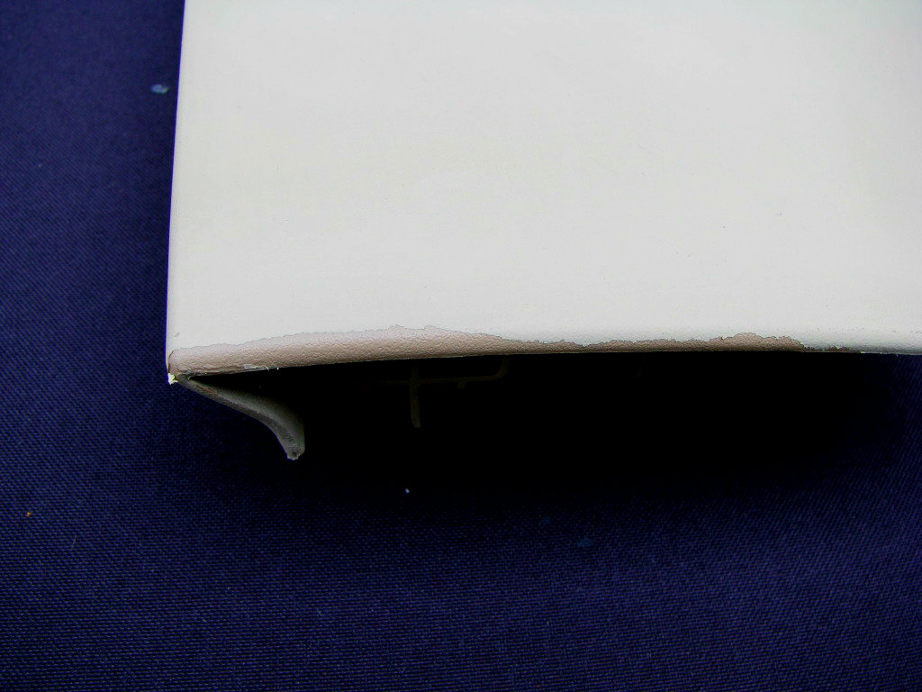

be careful as most trims are painted with a thin layer of trim paint, this can come of leaving the bare plastic. Shocked V8 facelift Range Rover Autobiography 22" wheels.

heres a pic of the tail gate trim, i went a bit to hard with the scrubbing brush, Big Cry now found out it was coated.
looks like i will have to get the air brush out and repaint the panels
