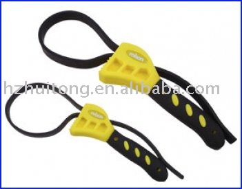

I would have thought doing this without taking the fan off will be a massive pain! As a word of caution do you have the correct fan tool? If not be careful. I used the belt tension to undo mine and Censored the water pump seals. It's possible they were on there way out and the extra force killed them. If I was to do it again without the correct tool I would sacrifice the belt and get one of these http://i01.i.aliimg.com/photo/v1/395407661...ch_Set.jpg would save the pump but also a good excuse to change the belt and at £10 better than being stuck at the side of the road. [img]http://www.fuelly.com/driver/rob2529/range-rover[img/]
