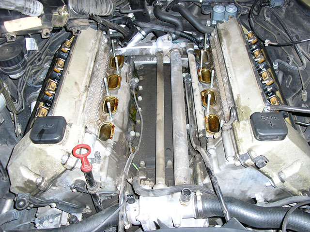

There are coolant hoses at the top back of the engine that feed off to the heater. They come from a manifold just above the bell housing so when they leak it drips down through the bell housing. The typical one to go is a short stubby one that converts from the manifold metal connection to the standard BMW plastic coolant hose clip connection. There are a couple of others but the short one is usually the culprit.
You can see it if you scroll to the bottom of this post:
http://www.fullfatrr.com/forum/topic23678.html?view=next
To give a better idea of the manifold position here it is with the intake removed, its at the back (don't worry you can get to the hoses over the top of the engine without removing the intake manifold):
N.B. Not an L322 but same M62 engine, the hoses at the back are different on the L322.
It could be the valley pan gasket but I think the drain hole for that is at the front of the engine, doesn't mean it won't find away down the back but I would check those hoses first.
