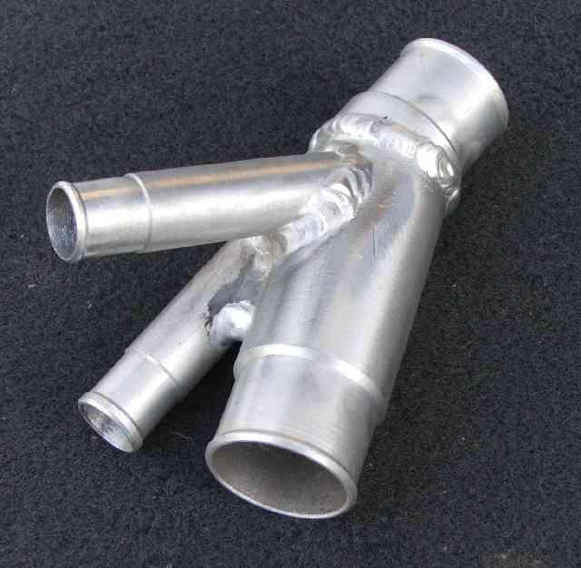

Overheating was always a worry with them.
I removed the thermostat from the bottom hose, fitted a sputnik in its stead and then a lower temp thermostat in the inlet manifold - an easy mod with the GEMS engines.
