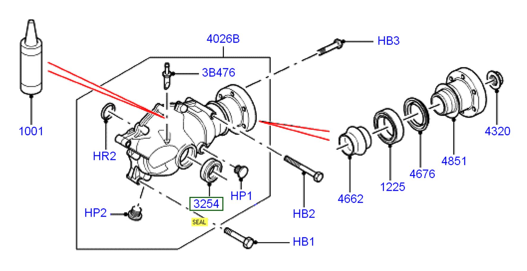

Hi all, I have to change the front differential oil seal, where the wheel joint fits, but I do not find it as a spare part from the land rover, how can I find it?
Thanks in advance

Do you mean the lip seal identified with the callout ‘3254’ in the Microcat diagram below?
If so, the part number is TZB000050. Costs less than £10, here in the UK.

yes, just that, thank you so much !!
