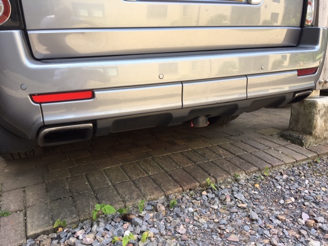

I guess that problem won't happen here in Oz, we use this type of towbar tongue (this is mine).

Farmers Hitch here Mr. Green it’s agricultural and can’t be noisy even with a perfect nose weight but it’s very secure, and when not fitted with the bung in the receiver the car looks great 👍
same here, I went for the farmers hitch because removed it looks less intrusive than the westfalia swan neck one. I got mine from pf jones also. my only concern is that some scroat could unpin the trailer very easily, so if I'm leaving the car and trailer I tend to padlock the two together.
