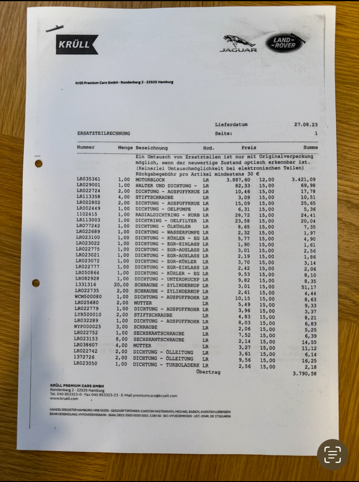

Here is the invoice from dealership. Can't really remember when it was delivered, maybe it was 10.2024

No mention of an oil pump and also no head gaskets, not sure how you would replace a block with using head gaskets? That was a very good price for a genuine shortblock, I paid just under £5k with discount in December 24 and see they are now just under £10k.
I think I'd change the hydraulic chain tensioners first as they aren't listed on your invoice and are a pretty easy change, definitely worth a go before going the oil pump route. L405 SV Autobiography LWB SDV8, finished in Aston Martin China Grey by ETO division.

The head gaskets were ordered separately and also the chain, tensioners and chain guides. I already ordered new OE chain tensioners, the passenger side tensioner arrived already and we replaced it - no luck, noise the same. Now in few days should arrive the driver´s side tensioner. I will give this a try.
