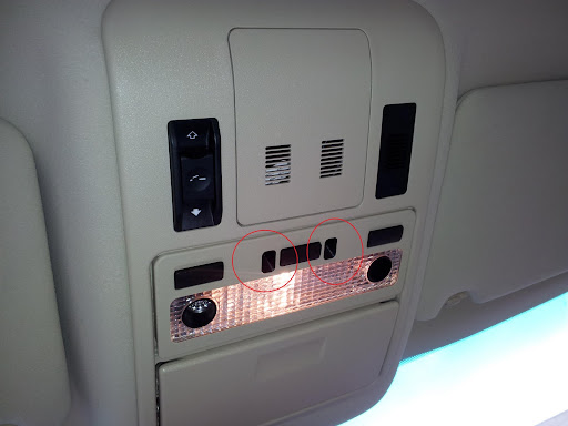

i stand corrected re the leds , looked like normal baynet type bulbs to me.....

Have you ever picked up a brochure for the car?
"There's 'waterfall' lighting situated in the roof lining, to provide gentle background illumination during night driving and enabling both driver and passenger to operate controls safely without the distraction of bright overhead lighting."

i assumed OP was on about the light below red circles in dans pic....
