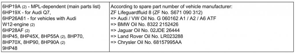

It’s imperative that any fluid change procedure uses the correct fluid – in this case ZF Lifeguard Fluid 8
ZF Lifeguard Fluid 8 was originally Shell L12108 so it’s interesting to see ZF’s recently-added reference to the Petronas Tutela fluid which is fully, rather than partially, synthetic.

This is a copy of the same section from ZF’s TE-ML_11 specification from exactly a year ago (January 2014) and, as you can see, there’s no mention of the Tutela AS8 fluid.
Phil
