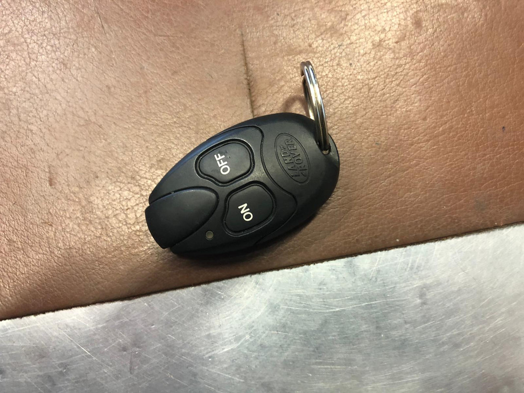

Hi Guys.
Sorry to bring this thread up again. Rolling Eyes
I have recently bought a 2013 L405 Autobiography which does have on the build sheet it has remote timed fuel burning heater etc.
Anyway I haven't got the vehicle yet it will be Tuesday when I pick her up.
I asked when I went to see it where is the remote for the diesel heater and he didn't have one so I guess the owner kept it.
But hey on a plus he did have a remote spare at his site and said he would leave it in the vehicle but I would just need to get it programmed.
I understand how to program it thanks to you brilliant guys but not sure if the remote is suitable to my vehicle?
Here is the picture of it.
Is this compatible with the L405 or do I need the newer style?
Any help would be appreciated.
Thanks guys Thumbs Up
Ross.

Hi all,
Sorry to revive this thread. I've got a 4.4 V8 diesel (2014) with the FBH. I know it works because I've tried the timed climate setting on the screen.
I've got a fob from a 2020 Autobiography (its the T91r with the heater symbol instead of 'off').
My questions are:
On a 2014 Autobiography is it definitely the 20A fuse in the boot?
Just because the car has FBH does it definitely have the remote functionality?
Is the T91r compatible?
The fob just flashes about 8 or so times when I press on or off, I can't seem to get the fob to want to pair to a new receiver.
Post #587405 14th Mar 2021 8:51am

Likely to be fuse 1 (5amp) in the fuse box behind the glovebox (based on my experience of an MY14 L405).
Post #587406 14th Mar 2021 9:01am
Justin017
Member Since: 14 Mar 2021
Location: Essex
Posts: 5
United Kingdom 2014 Range Rover Autobiography SDV8 Santorini Black
Hiya,
I’ve also tried that one. The symbol for that fuse suggests it’s some sort of vehicle receiver as it shows a car with air waves going through it but I still get the same result there. If a fob is already paired with another vehicle is it the same procedure do you know?
Post #587407 14th Mar 2021 9:06am
JCW
Member Since: 13 Apr 2013
Location: Cotswolds
Posts: 963
It’s the fuse for the Telestart fbh receiver, sounds like that’s the right fuse.
Yes same procedure - may be the fob you’re using in which case, not sure if an MY20 will be compatible, can you add a photo? Should look like this

Justin017
Location: Essex
Posts: 5
Sure no problem. Photo attached.
I know the fob works because it was working on the 2020 car it came from for sure.
I’ve even tried taking both fuses out and same result
Post #587409 14th Mar 2021 9:19am
JCW
Location: Cotswolds
Posts: 963
That looks like an older MY fob to me.
Post #587410 14th Mar 2021 9:22am
