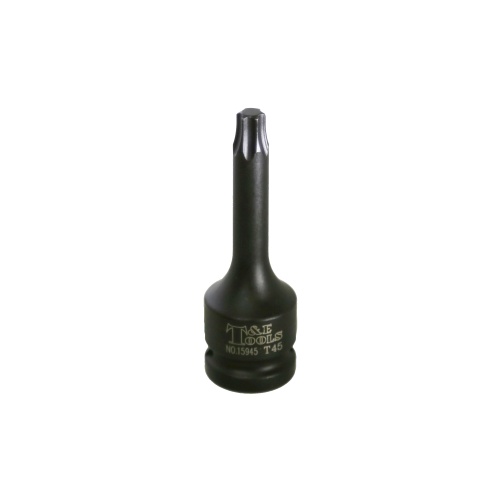

All we use for jobs like that is one of these in the torque wrench
And a 1/2" bar with a T45 bit, works every time...

Those 'plug in' to the torque wrench in place of the ratchet head, you can get versions that are essentially a ring version of a crowfoot wrench that has a 1/2" square drive hole in it.
Random internet photo of one
This single piece type of Torx bit tend to be better quality than the softer ones used in the chromed drive adapter sockets

I will grab a 21mm or 13/16” “box end torque adapter” and an impact Torx T45 for the next time I have to replace them.
The Torx tool I was using is a single socket and claimed to be impact grade. It was coated black, but was regular chrome vanadium. I will find a real impact grade one.
