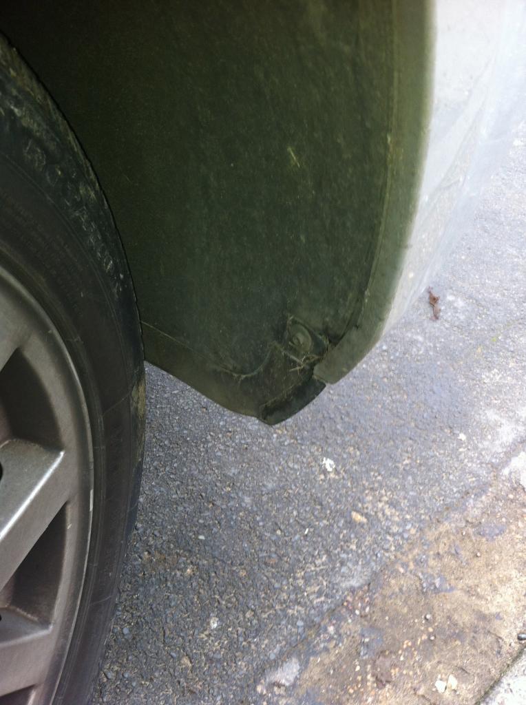

I had one of those god awful rubber bull bars on the front of my FF and have wanted rid since i bought the car. After recently parking the FF in the front wall of the in-laws, accidentally damaging the corner of the front bumper (you can just make out the black patch on the right in the picture), I ordered a 2nd hand bumper off flea bay. Ł110 in my colour with parking sensors and fog lights still attached.
I took some photos as I went and as it turned out to be a pretty straight forward job, i'll share with you and hope someone else can benefit from it.
As it looked:
