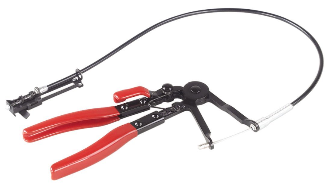

I checked before buying my SC that the wiring had been rectified by Land Rover. They had not changed the pump though! It startet to act up, sometimes it ran like it should somtimes it did not start at all. When wired backwards it runs full time, this wears it out. I would really recommend this tool to change the pump, made it very easy.
