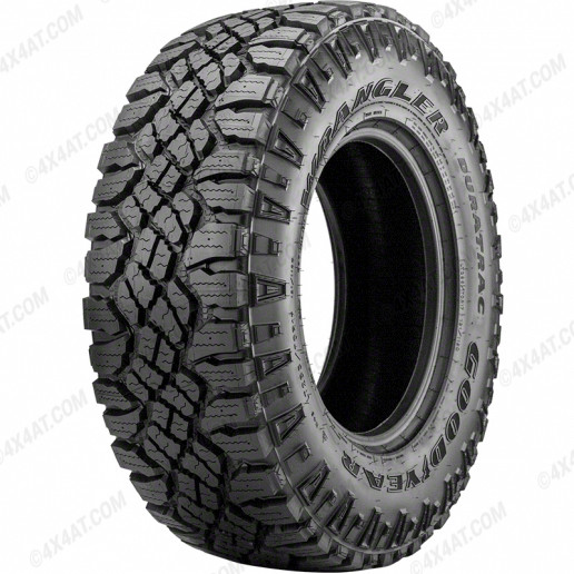

Great car you've got yourself, I had the same vehicle and fitted Goodyear Wrangler Duratracs which I've also had on my L405 for 3 years and they save the need for different summer/winter sets of wheels.
They are a brilliant all round tyre, good dry and wet grip, never aquaplane due to deep big tread, great in ice and snow, more aggressive tread than AT so better in muddy fields where an AT will quickly fill with mud and become useless and although they do make a little more noise at motorway speeds I've done 1000s of miles on the motorway with no problems whatsoever.
The only downside is the speed rating is 99mph but I didn't want to exceed that anyway as you risk your licence!
I'd consider them and your real need for 2 sets of wheels.
They also make the vehicle look more purposeful than normal road tyres.
