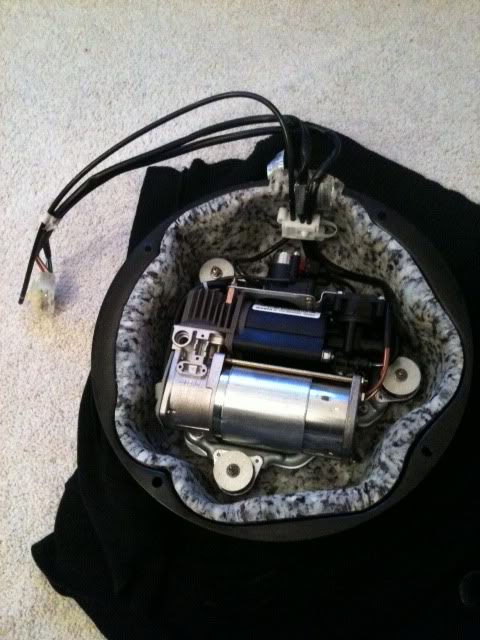

As soon as i got back from work, i went straight into the car, disconnected the battery and then disconnected the eas pump. i undone the 4 screws around it however i came across an issue. i managed to unlug the electrical wires however as per the picture how to i unplug this so i can take the unit inside my house so i can properly dry it out.
also the unit seems to be sealed with a padding inbettwen where it joins etc i would imagine this is possibly where the water has soaked up from and got inside, if i split this open i will i rejoin it, will it be a case of super glue etc.
any other info be gratefull recieved.
thanks
Post #85891 7th Oct 2011 7:58pm
Where the plastic pipe meets the metal part you need to push the collet in towards the metal part and pull the plastic pipe out. Use a small open ended spanner on the collet to give you more leverage

hi mate, i actually literally just managed to figure that out, ive got it in the house and infront of a halogen heater, any other advise on "fixing it" besides blow drying it and heating it Razz

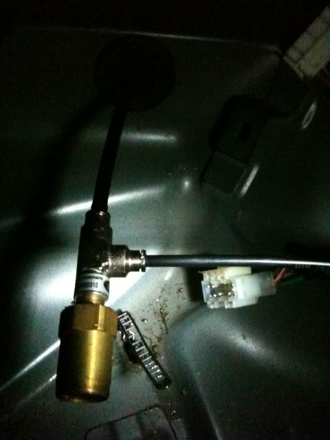

One thing keeps coming to mind, i have seen a few posts where people say there is sometimes a problem with the actual release value and i would imagine this is the brass cylinder that is in my pics at the end of the air pipe.
would it be a good idea to take this off ? and if so how would i do it, i have heard people say just use the T section to connect the two pipes. any idea how to do this, i would just go figure it out myself however the complexity of this beast makes me reluctant to "trial and error" with it.
thanks
Post #85973 8th Oct 2011 9:39am
Once you have the compressor refitted and working leave the rear tyre cover off and try lowering the suspension, you should hear the valve dumping the excess pressure if it is working properly

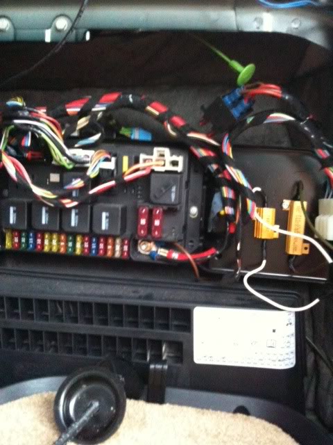

Guys, is the fuse in the back or the front of the car for the compressor ?
I assumed it was two 20amp fuses in the front ? i checked them and they are ok, is it in the back ?
apparently the black box on the far right is the eas compressor supply unit relay, could this be faulty, causing it not to work ?
