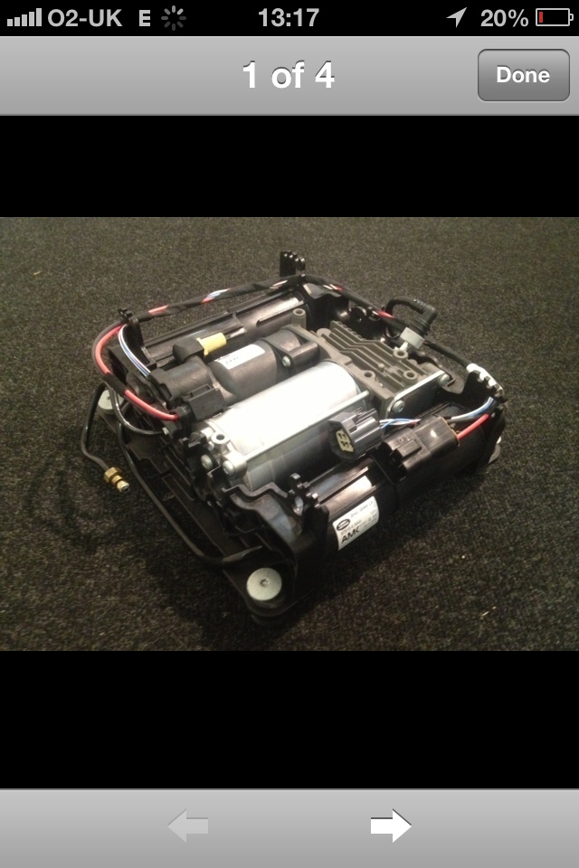

Another twist to the tale for god sake!
My friend at landrover has just got back to me and said the one iv bought is for an 06- range rover and that it won't fit, here's some pics of the one iv bought that was advertised as an 02-05 compressor.

Durham4416 you may well have the wrong compressor there these parts were handled by Finning the Caterpillar people (don't know if they still are ) and they got a whole lot incorrectly boxed up . 2008 MY Supercharged

I bought it off eBay, it was advertised as an 02-05 compressor when it is in fact a 2006- one, I'm trying to get a refund as its not as described and then I am just going to get my Indy to supply and for one on Monday when I get back, in just hoping the suspension stays up as it seems to have dropped a little , I was contemplating disconnecting the battery to try and clear he fault codes and see if the compressor would manage to just lift it back to standard road height but not sure if its a good idea or not :s
